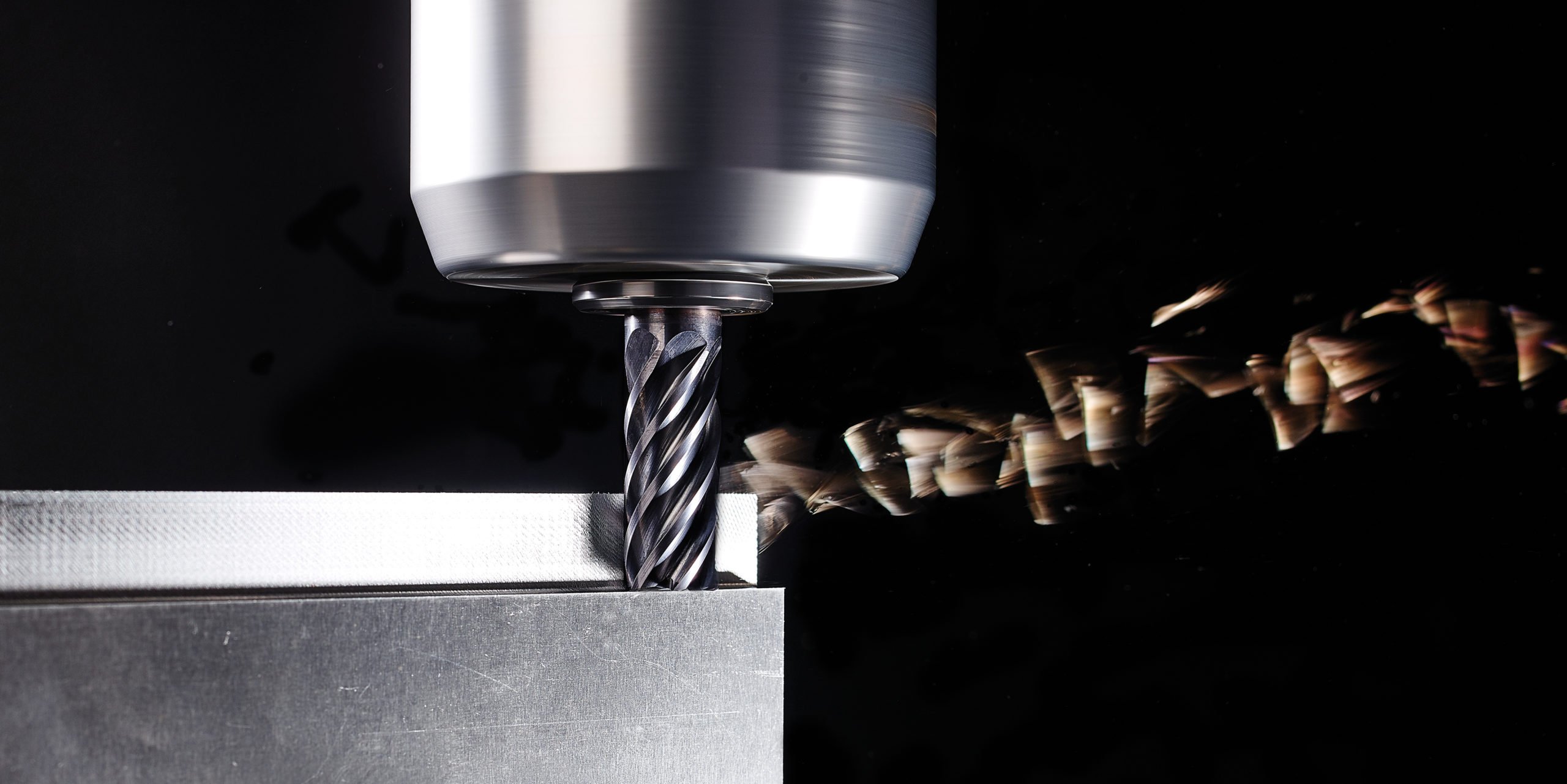

Despite this speed and torque variation, the KM4X interface can achieve performance with particularly small bending deformation. Under testing on a 12,000rpm machine with 37kW of grunt, a HSK63A toolholder can maintain a clamping force of 18kN whereas the new Kennametal KM4X retains a clamping force beyond 47kN, more than double the industry standard configuration. The difference for HSK100A and HSK125A configurations is equally impressive. The impact of a solid clamping foundation can have a profound impact upon tool life, MRR, surface finishes and overall productivity and throughput – facts that both Dr Adrien Cellier and Werner Penkert were keen to emphasise. Looking specifically at the cutting tools, Kennametal has a multitude of solutions for the aerospace industry, but this seminar focused particularly on the 5720 series of aluminium machining cutters for high-speed slot and copy milling in aluminium, the high-speed HARVI III solid carbide milling for semi-finish and finishing operations on titanium alloys, and of course the impressive HARVI Ultra 8X helical milling cutter.
