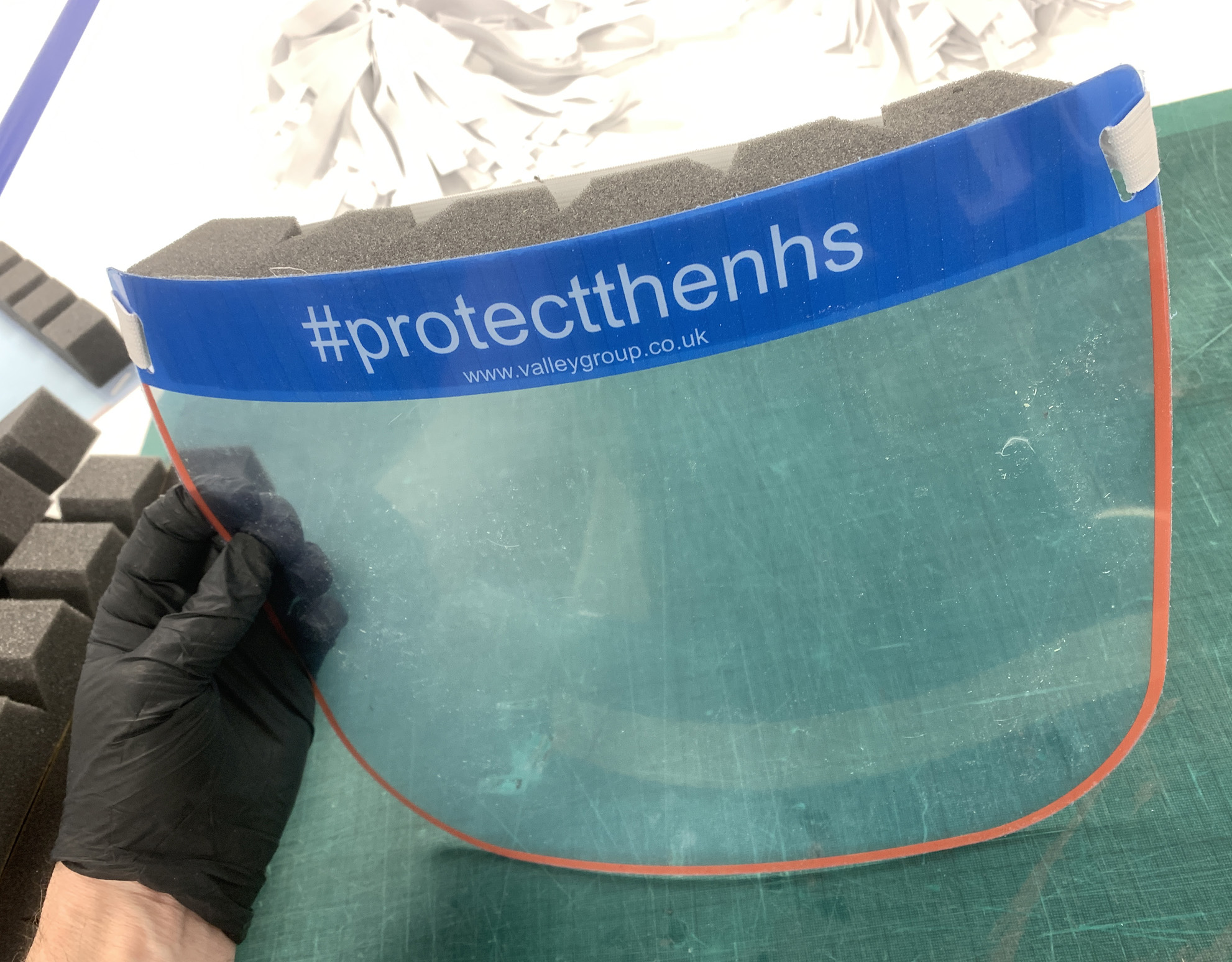

One critical factor was the cutting of the 0.5mm thick PETG face visors that had to be free from burrs. Luckily, the Valley Group has been a customer of ITC for over 10 years, so when it came to cutting thin plastic sheets, the Tamworth cutting tool manufacturer stepped in with advice.
Commenting on this, Mr Dawson recalls: “With high production volumes and rapid turnaround times, we couldn’t afford to be hand finishing the masks. ITC recommended the Clearcut 180 Series of solid carbide single flute downcut routing tools. In little more than a weekend, we have produced over 1000 masks for Hywel Dda and we now have a firm order from Bridgend County Council for another 5000 masks. Additionally, we are currently awaiting testing and certificates required by NHS Wales to supply all Wales’ health boards. We are starting a second shift to produce 700 to 1400 masks per day.”
Concerning the ITC tools, Mr Dawson says: “We initially ordered one 6mm 180 Clearcut routing tool and with a high number of facemask orders, we ordered an additional 6 tools. However, we have produced over 1000 visors and the first cutting tool hasn’t even started to wear. The edge finish on the visor is still of the utmost quality with no sign of the plastic burring or creating rough edges.”
