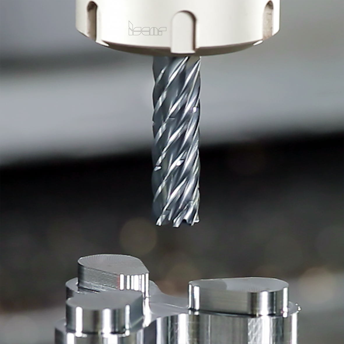

Even a brief examination of the above shows that multi-flute solid carbide endmills (SCEM) comply with the requirements in the best way. These endmills have their own design features that can be identified in the latest ISCAR product line. Several features characterise these products: a) different helix and variable angular tooth pitch that provide a vibration-resistant design to improve stability in HSM with high overhang, b) a specially shaped flute that results in an increased core diameter to improve dynamic strength, and c) enough space for chip gullet to ensure smooth chip flow. The diameter range of ISCAR’s SCEM for trochoidal milling is 2-25mm.
CHATTERFREE EC-E7/H7-CF solid carbide endmills have 7 flutes and a variety of corner radii. They are available in a series of two, three, four and six cutting length-to-diameter ratios. The endmills are produced from PVD coated ultra-fine carbide grade IC902. The key distinctive feature of 7 flute endmills ECP-H7-CF (Fig. 1) is the chip-splitting geometry of a cutting edge. Introducing this geometry provides increased performance at high overhang and significantly improves chip evacuation in machining deep pockets and cavities.
If trochoidal milling is applied to shallow slots or corners of titanium parts, 6 flute MULTI-MASTER exchangeable heads that were recently introduced may be a more suitable solution (Fig. 2). The head design has enabled a robust product for efficient machining hard-to-cut titanium grades such as Ti-10V-2Fe-3Al and Ti-5Al-5Mo-5V-3Cr. This review would be incomplete without some notes about tool holders, which are essential to the success of trochoidal milling. Machining practice shows that the best results are reached when the milling cutters are mounted in hydraulic or heat shrink chucks.
