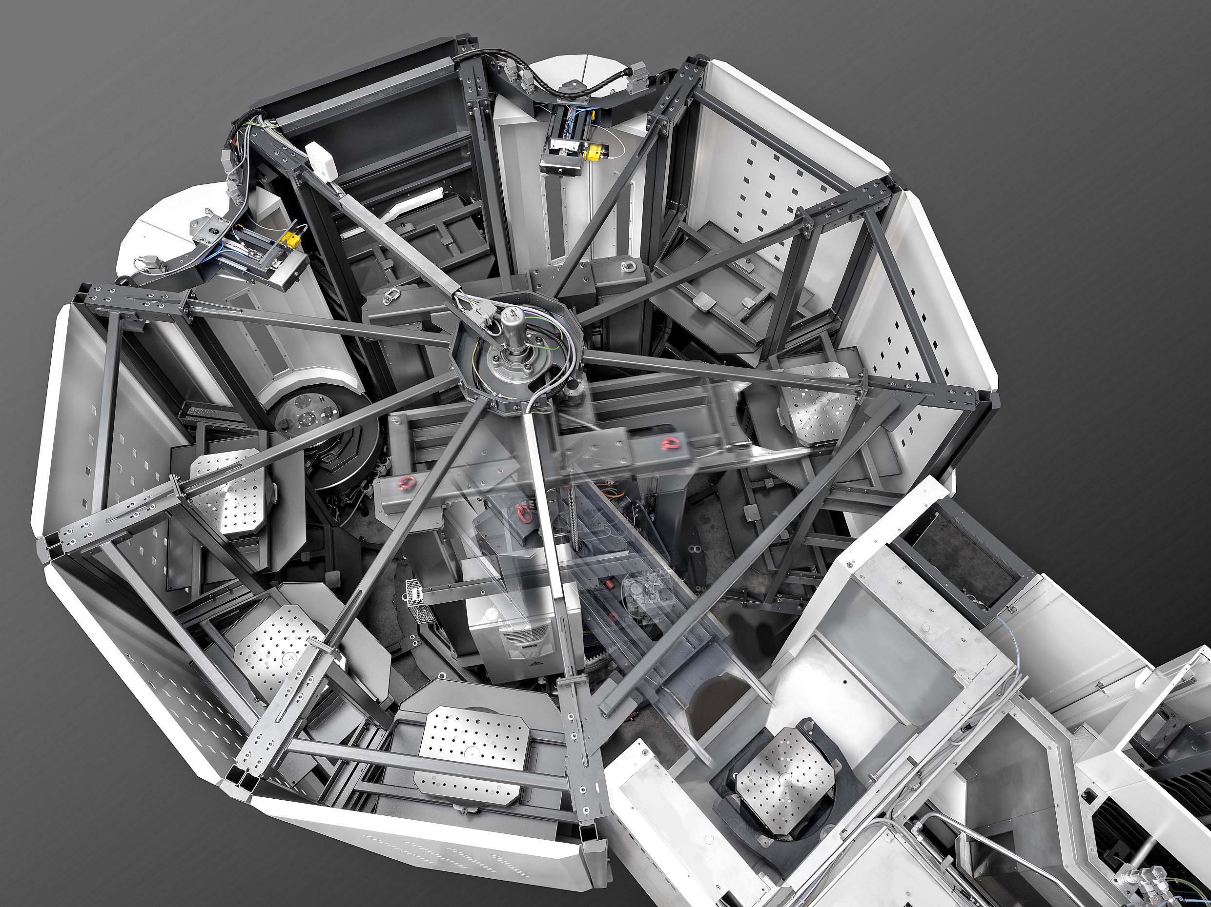

Highlights of the new generation include new swivelling heads with integrated motor spindles d and an optional direct-drive torque table for carrying out in-cycle turning operations. A pallet changer is included, enabling easy integration later on of a rotary or linear pallet storage system.
To ensure that all of the above benefits are maximised in production, Heller’s design engineers have focused on clear and easy operation, as well as good accessibility to all work areas. Operation is simplified by the new Siemens Sinumerik ONE control, which is fitted as standard, and the convenient control unit in panel design with a 24-inch touch screen. At the same time, better access to the work area and the optional new SETUP-Assist software make it easier to prepare for the next machining process.
The main purpose of automated manufacturing in production centres is the reduction of idle times to optimise system availability. For this purpose, Heller offers proprietary automation solutions that can be optimally combined with its HMCs.
