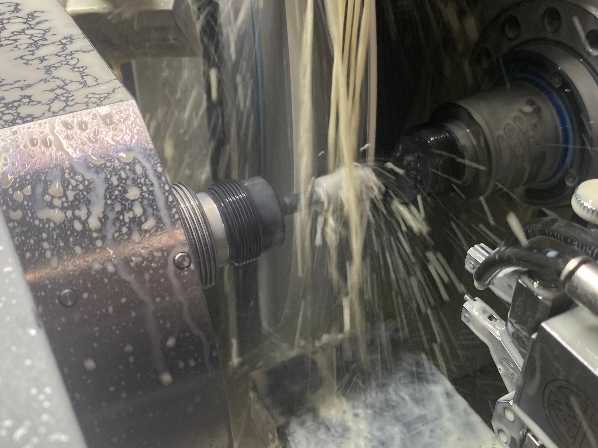

Located in Honley, HB Bearings is celebrating its 50th year in business in style, investing in the latest Kellenberger grinding centres from DF Precision Machinery. The latest addition, a K100 grinding centre with a Wenger automation system has cleared a backlog of two months of work in just two weeks.

The Kellenberger K100 is a universal CNC OD/ID grinding machine for use across medium to large-scale universal grinding applications. The Swiss-Made Kellenberger K100 grinding machine supplied by DF Precision is highly configurable and offers a wealth of options to accommodate the widest range of universal grinding operations. It is the combination of flexibility along with a proven track record at HB Bearings that has kept the Huddersfield manufacturer buying Kellenberger machines. HB Bearings specified the Kellenberger K100 with a Wenger WeStep 650 automation solution. The WeStep 650 is capable of loading shaft parts up to 650mm long and up to 260mm diameter, HB is optimising this capability to run components from 7mm up to 38mm diameter in high batch quantities, the parts are fed in pallets that are drawn in and processed by a chain conveyor. Pallets are indexed under the line gantry and when a pallet of parts has been processed, it is placed on the upper finished parts conveyor and removed at the operator’s side.
Looking at this productivity, Katrina Wood adds: “This machine has speeded up the number of rollers we are making in a day. We were making around 90 rollers and this machine can do 400 to 500, depending on the size. If the size is smaller, we can do a bigger batch within a day. It’s had a massive impact on the business. I don’t have to worry about the rollers, the quantities or quality when I’m issuing jobs or when I’m thinking about the deliveries. This isn’t a problem to me anymore.”
