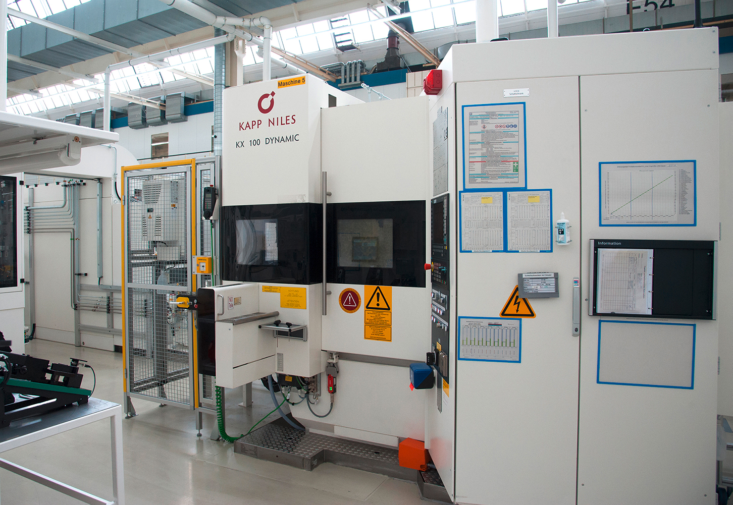

A total of seven Kapp Niles machines are being deployed at VW. The machines include three KX 100 DYNAMIC, two KX 260 TWIN in wheel production and two KX 160 TWIN in shaft production. Christian Hahn and Bernd Kümpel agreed from the very beginning that the desired cycle time could only be achieved with a combination of several measures. To minimise daily set-ups, Christian Hahn makes sure that the wheels to be produced on one machine have boreholes of the same size. Thus, he has to change over the machine, but not the clamping tools. The remaining set-up time is minimised by the set-up concept of the KX 100 DYNAMIC. For one machine, he needs just 20 to 25 minutes. “The semi-automatic set-up makes the   KX 100 DYNAMIC extremely user-friendly,” says Bernd Kümpel, describing the process.
Additional visual aid is available in the form of a menu guide and an easy-to-understand cycle on the machine controller. By completing the step-by-step process and the acknowledgement screen, the operator ensures that no work steps are executed incorrectly and high-cost failures are prevented.
The tools are dressed using full profile rolls, allowing all threads of the cylindrical worm to be approached and moulded simultaneously. Thus, with a 5-pass full profile roll, the dressing time can be reduced by more than half without compromising on quality.
The integrated measurement system is another important time-saver. Christian Hahn explains the advantage: “After each changeover, quality measurement has to be made outside the machine. We continue to require this, but I can already check the basic, quality-related parameters with the integrated measurement sensor in the machine itself. It saves a lot of time  as we can start production before the results of the external measurement are available.” The integrated measurement system of the Kapp Niles machines accelerates the restart process considerably. The external measurement merely checks more teeth and generates the measurement report to monitor the gear.

Production is characterised by belt chaining that goes through the entire hall. Available space is limited, hence, the highly compact KX 100 DYNAMIC machines are the preferred choice. This machine type has two separate rotatable mounted columns, each with vertically movable pick-up axes with one workpiece spindle. While a workpiece is being machined, the other pick-up axis places the machined workpiece and loads a non-machined part onto the workpiece spindle. The workpiece is aligned outside the work area. This allows the workpiece spindle, already accelerated to machining speed, to be swivelled in the work area, keeping non-production times to a minimum.
A transfer unit does the loading and unloading from the conveyor belt. Bernd Kümpel says: “We usually move with the belt directly below the machine. However, this was not possible here. With the transfer unit, we compensate for height and distance from the belt to the machine. An integrated automation solution would have been significantly more expensive, at about 25% of the priceof the machine,” addsBernd Kümpel. “A simple transfer unit costs less than 10% of the machine price.”
