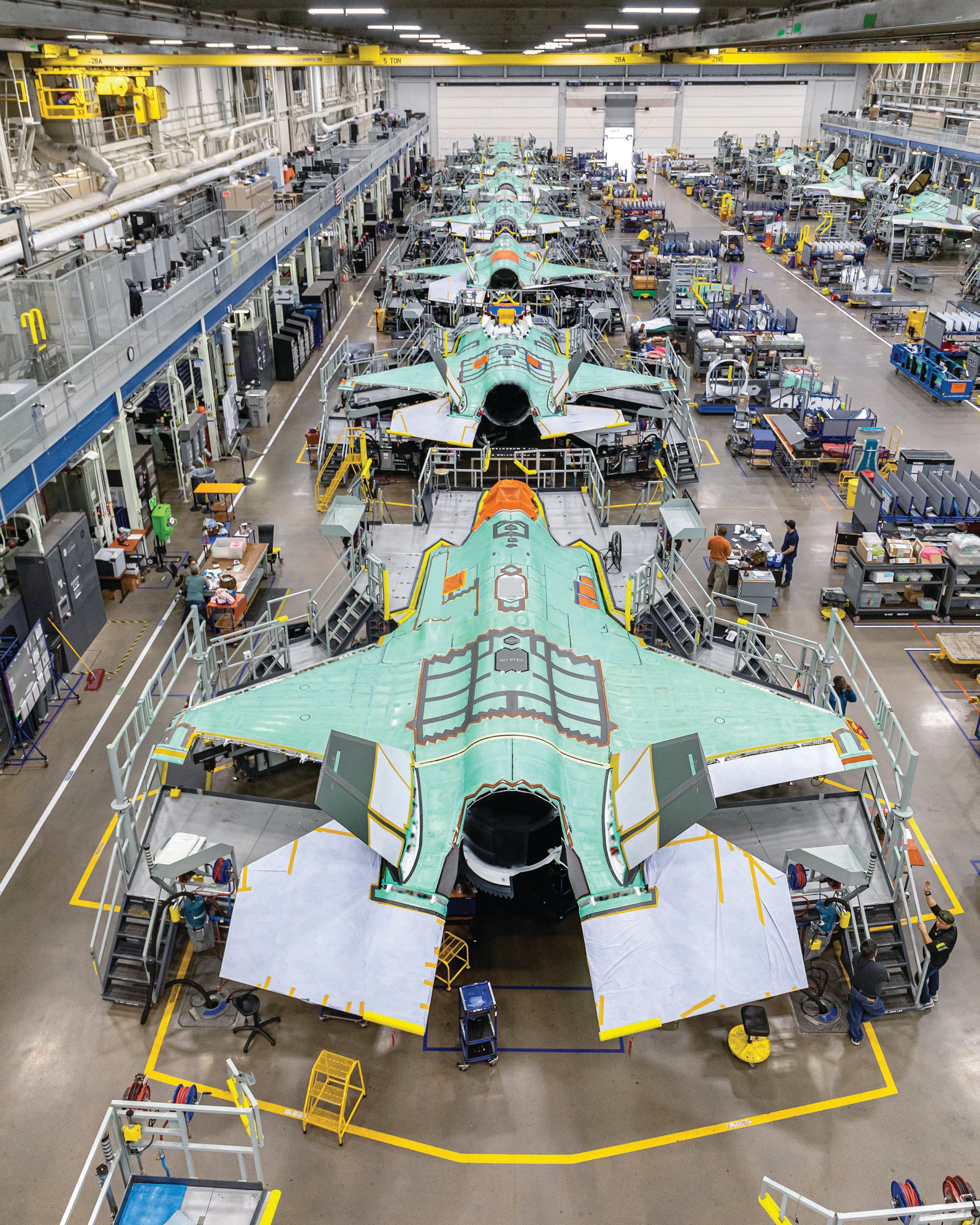

The Lockheed Martin F-35 Lightning II combat aircraft is a long-range supersonic fighter with stealth capability that enables it to evade detection and enter contested airspace. The F-35 also provides impressive connectivity, serving as a communications gateway to share its operational picture with allied ground, sea and air assets. On the ground, the same characteristics of speed, connectivity and technology are recognisable in the manufacturing operations of this fighter.
As the prime contractor for the F-35, Lockheed Martin works with a global supply chain of more than 1,900 companies based in the US and the 13 nations acquiring the aircraft. Lockheed builds the forward fuselage and wings in Fort Worth, Texas and the evolution of machining operations for the cockpit-area forward fuselage understructure demonstrates Lockheed Martin’s commitment to continuous improvement.
