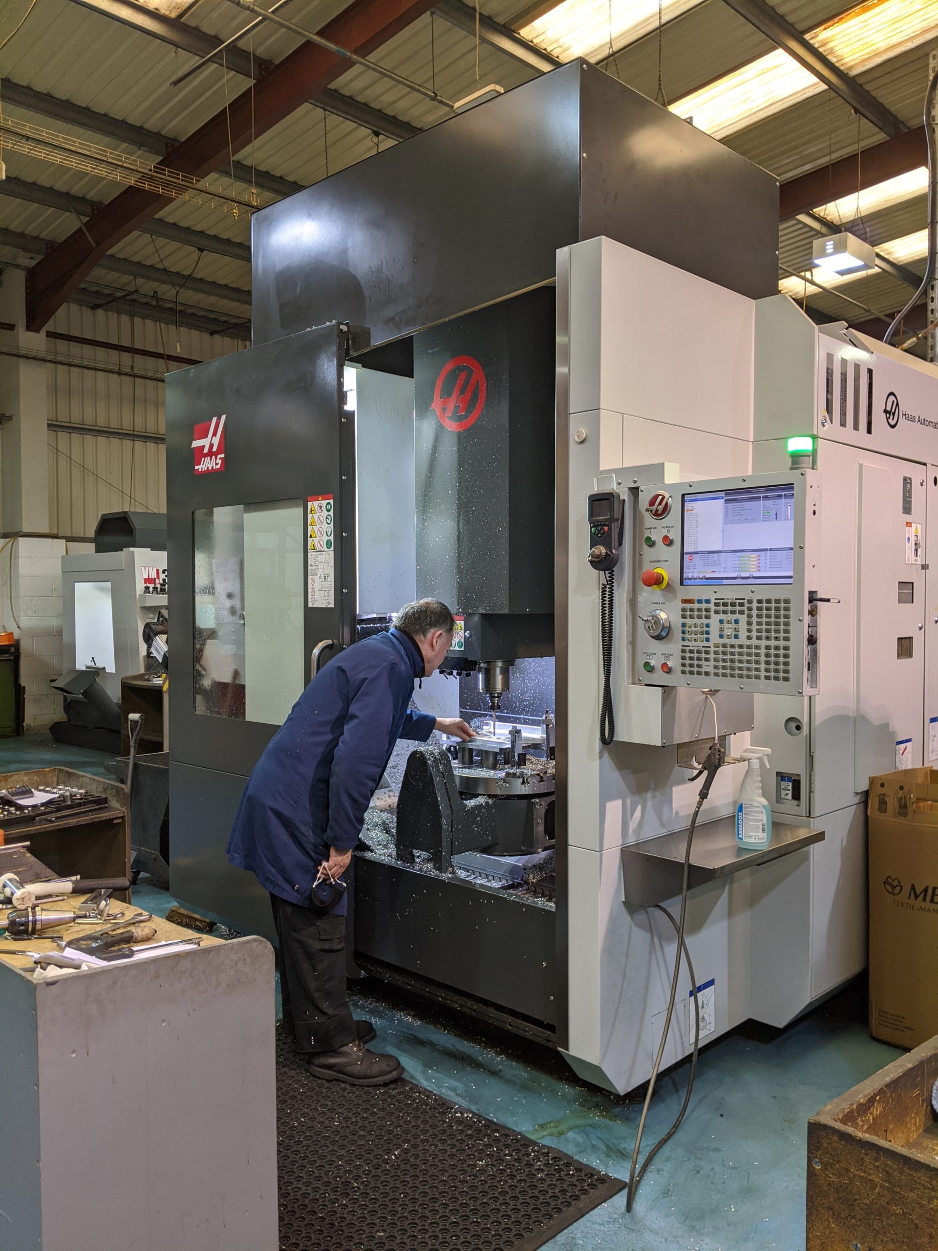

Specifically identifying the benefits of the HAAS UMC750, Elle Flinn-Shephard continues: “The UMC750 enabled us to take on two higher volume production jobs from two different customers; one of which was oil filter housings which we did 3 runs of, machining around 150-off overall. On one of the two jobs, we managed to get the process from four operations spread across four machines down to two operations. The HAAS UMC750 enabled us to use only one VMC and then finish the job on the UMC, rather than splitting the work across four machines. We have been more efficient and accurate using this 5-axis capability and this has helped us during the pandemic. The 5-axis machines have made a significant contribution to us retaining our existing customer base as well as gaining new customers throughout the pandemic.”
“The HAAS machines suit our type of work. They are quick, accurate and robust. We’ve also had excellent after-sales service from the company. This HAAS UMC750 was a strategic decision as it has allowed us to win bigger work. This is a credit to the machine having a much larger work envelope than the trunnion machines, as the table rotates rather than using a ‘bolt-on trunnion’ that reduces the working area. It has a tool probe for setting our tool offsets and it is far more accurate and faster to use than entering offsets manually. This processing speed is created because the machine only needs one datum offset, as it tracks the programme datum – again this is more accurate and quicker to set than the trunnion machines.”
