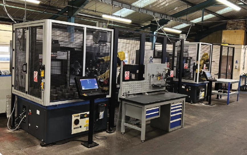

Mills CNC has recently supplied Ayrshire Precision, a subcontract specialist based in Ayrshire, with two new SYNERGi systems. The systems, both derivations and highly customised versions of Mills’ standard SYNERGi ‘SPRINT’ solutions, were installed at Ayrshire Precision’s 14,000sq/ft site. In 2023, the first system was retrofitted to a Puma 2600SY lathe, and six months later, the second was retrofitted to a Puma 2100SY.
SYNERGi Sprint automation systems are compact, flexible, and cost-effective. Mills’ dedicated automation experts can integrate them with DN Solutions’ lathes, machining centres, and mill-turn machines to create high-productivity automated manufacturing cells.
The essential elements of a SYNERGi Sprint system comprise an industrial FANUC robot with varying payloads and reaches, a two- or three-jaw pneumatic gripper, a 900 by 900mm part loading/unloading grid plate, and industrial safety guarding positioned around the system. Mills can also supply customers with multi-socket inserts to optimise each system’s capacity. These are sheet metal fabrications that customers can also choose to manufacture for themselves.

Ayrshire Precision’s first manufacturing cell was installed in March 2023. The cell comprises a Puma 2600SY multi-tasking lathe and a FANUC 35kg industrial robot with dual Schunk 3-jaw grippers. Other elements include Renishaw probing systems, safety caging, and the system’s HMI control driven by Mills’ proprietary SYNERGi software.
With individual part cycle times of approximately 10 minutes, Ayrshire Precision is now benefiting from up to an additional 16 hours of unmanned operation of its Puma 2600SY lathe. Since installation, the company has manufactured different sheet metal pocket inserts to accommodate larger parts and different batch volumes.
Ayrshire Precision’s second SYNERGi cell was installed in September 2023. This cell incorporates the Puma 2100SY lathe, a 20kg payload industrial robot and a 900 by 900mm table for processing smaller components. The automation process for both cells involves the robot picking up a workpiece from the grid plate in a programmed sequence and, using the lathes’ auto door opening facility, loading the part into the machine’s main spindle. The door closes to enable the machining of the part’s front end.
After all machining operations are finished, the robot picks up the next sequenced workpiece from the table and, in one continuous movement, loads it into the main spindle. Then, it removes the finished part from the sub-spindle and returns it to its designated position on the table.
Says Chris Hepburn: “Every time the auto door opens, a completed part is removed from the sub-spindle and a new part is loaded into the main spindle. The process is fast, seamless and continuous. Furthermore, one staff member can operate both cells simultaneously.”
With less labour intervention required, Ayrshire Precision’s small part turning operation is now more efficient and profitable. Creating its two cells has also helped free up a couple of its operators, enabling them to be deployed to other machine shop areas.
Chris Hepburn concludes: “The investment in our two SYNERGi cells is paying dividends. We have two inherently flexible automated cells that have not only helped us future-proof our small-turned-part operations but have also increased our overall capacity. Although there was initially some anxiety concerning our move towards automated production, the results exceeded our expectations.”
