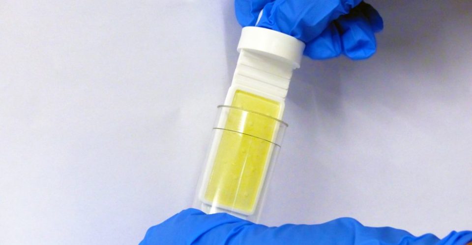

What is a dip slide?
A dip slide is a plastic paddle that has a layer of jelly like substance on either side of it. This jelly is called agar and is a culture media that will grow micro-organisms. Different agars grow different types of microbes. For testing metalworking fluids, the MCBTM2 dip slide has an agar for a total aerobic bacteria count on one side and a yeasts and moulds count on the other side.
After testing a sample, bacteria, yeasts and moulds colonies will grow on the dip slide. Any dots on the dip slide indicate that you have microbial growth within your system.
How to use a dip slide
  1. Wear gloves (if there is no danger of entanglement in machinery) to protect hands from exposure to metalworking fluids.
  2. Remove the dip slide from its tube. Place the dip slide into the metalworking fluid sample for 10 seconds. Make sure that the dip slide is fully covered by the fluid.
  3. Remove the slide from the fluid and let any excess fluid drain off before placing the dip slide back into its tube.
  4. Put the dip slide into a compatible incubator and allow to incubate for the appropriate length of time (24-48 hours for the bacteria side & 48 – 120 hours for the yeast and moulds side).
  5. Compare with the included chart to find your result. Log result on a paper record sheet, log book or Excel document.

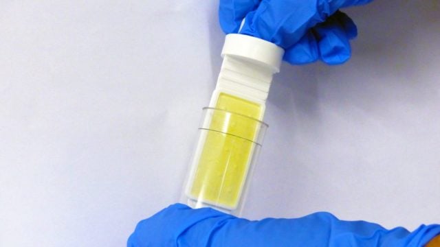

What the results mean
Upon checking the dip slides after incubation, you will more than likely notice dots on the agars. The total bacteria side of the dip slide will have red dots on whereas the yeasts and moulds side of the dip slide will have clear or fluffy bumps. These dots and bumps are microbial colonies.
The results are calculated in CFU (colony forming units) / ml*. Approximately 1 ml of sample is absorbed by the dip slide when testing. When you have taken the dip slide out of the incubator, you count the colonies and compare with the full colour chart included with the dip slides. When you find the image of the results that best matches the growth on your dip slide, you then record the reading associated with that image as your result (e.g. 10 3 cfu/ml).
*The only exception to this is when calculating the mould result, which is recorded as either light, medium or heavy.
