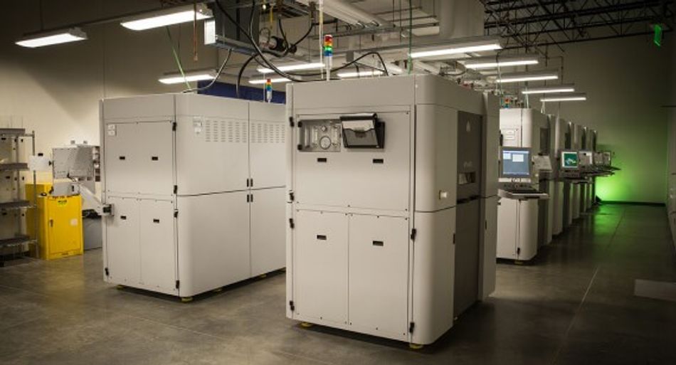

On the other hand, polymer based PBF processes are unique in that parts do not require support structures. Selective laser sintering works in similar way to metal PBF processes. Powder is loaded into the machine and a laser is used to sinter or fuse the particles together. Multi Jet Fusion (MJF) works slightly differently in that fusing agents are first applied to the powder material and then a heat element sweeps over the bed, which then fuses the material together. This is a slightly more efficient process which makes MJF a good option for larger volumes of nylon parts.
