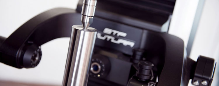

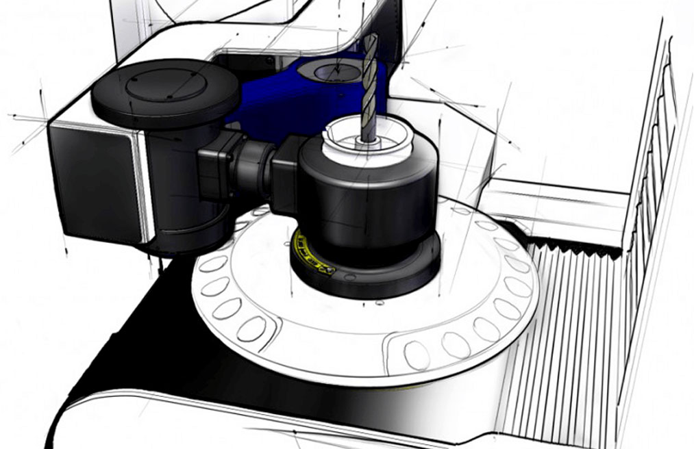

Understanding the Need for Tool Presetter
Contrary to a prevailing myth that tool presetters are only for boring bars, the tool’s precise measurement is crucial, regardless of its type. Ensuring accurate measurements and relaying the data to the machine allows for more efficient control over machine operations, leading to consistent part production.
