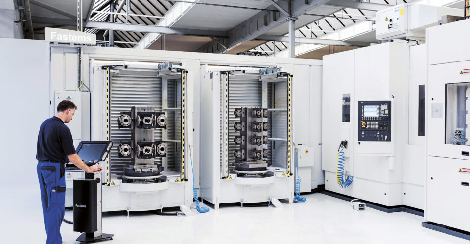

A pallet pool is an easy-to-buy, easy-to-implement automation solution for machine tools. It increases the lights-out manufacturing periods and machine tool utilisation by up to 65% – no wonder it’s such a popular option.

In a pallet pool, the number of pallets used per machine is limited. In contrast, having a pallet storage with two to five levels allows flexible automation to store machining and material pallets in a very compact floor-space. The more machines (and pallet pools) you would need, the more space savings flexible automation can provide.
