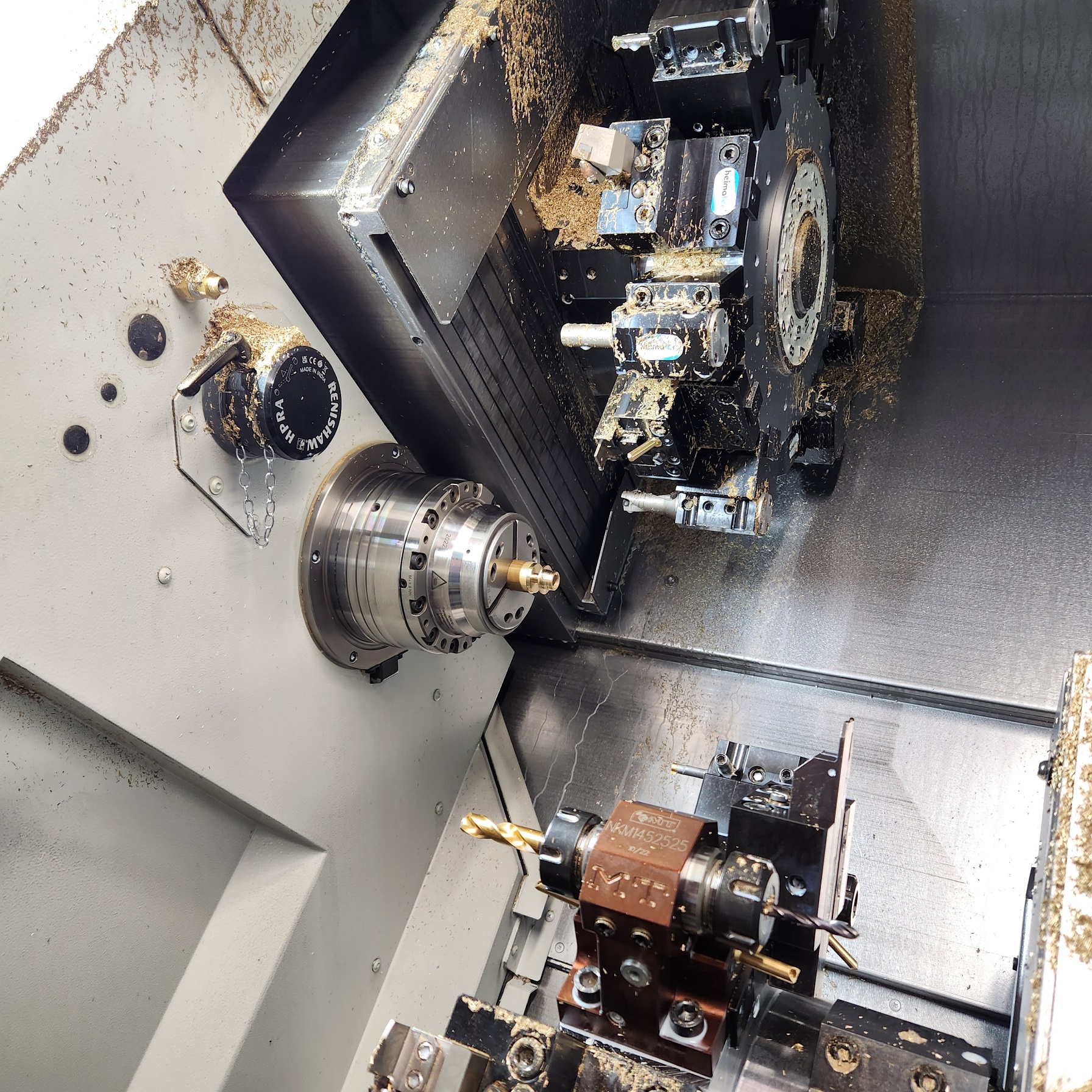

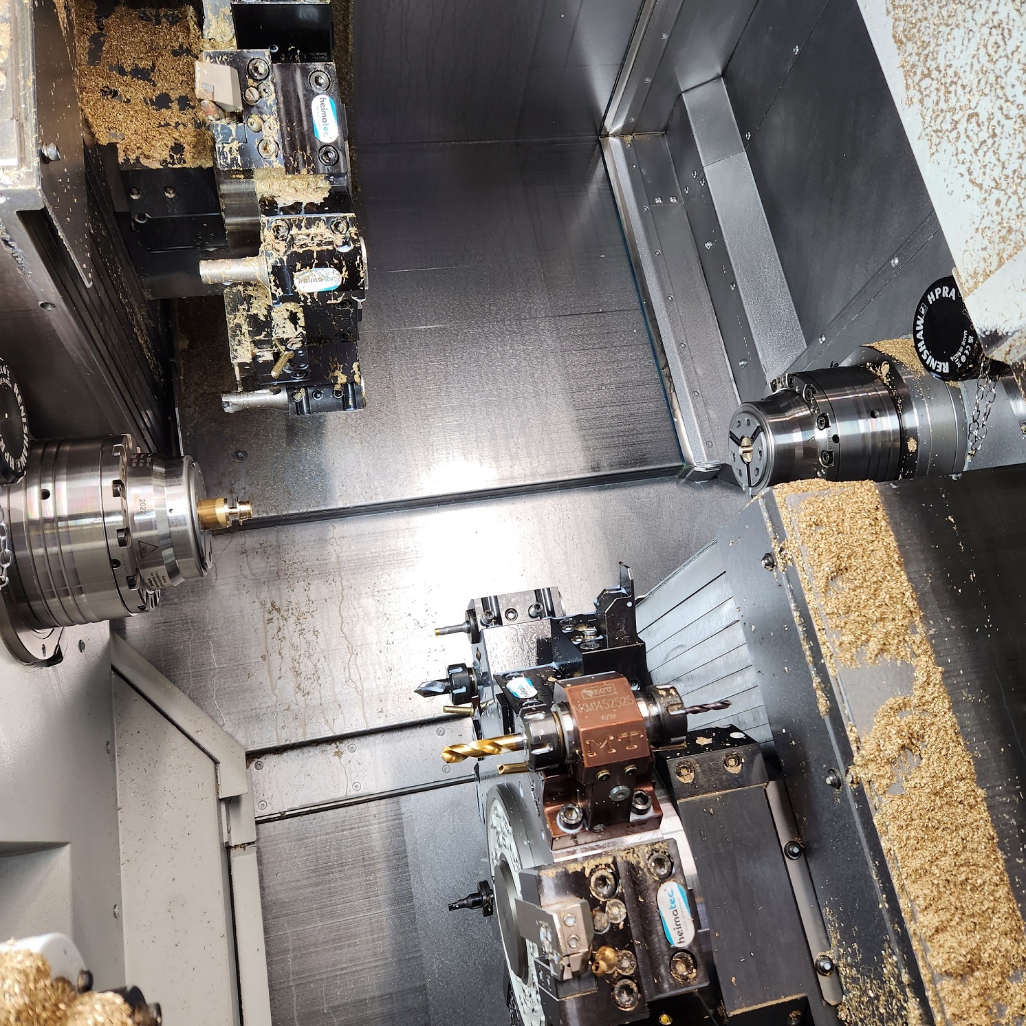

The company searched for a twin-spindle twin-turret turning centre with an intuitive CNC interface that could offer both conversational and G-code programming. As Ian adds: “We wanted a user-friendly machine that is very capable of machining the range of parts we produce, but we got so much more. One factor that drew us to the Nakamura is the oscillating servo (oscillation cutting) that prevents long stringy swarf and enables us to extend our unmanned running. This was particularly important to us as we have a family of nylon parts required in production runs up to 10,000-off. This project for the rail industry is a family of 40mm diameter parts up to 100mm long that we can set up on the Nakamura and it will eventually run for days without manual intervention. In fact, it is the swarf-breaking technology and the ability to run long unmanned periods that won this contract for our business.”

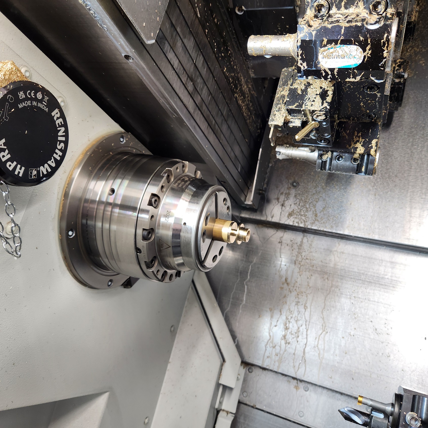

However, this project was won due to the Nakamura WT150IIF already being in place. What made the decision to invest in the robust turning centre was a brass electronic component for the construction and earthmoving equipment sector. The brass electronic part is regularly machined in batches of up to 15,000. Discussing this part and why the Nakamura WT150IIF was needed, Ian adds: “This part was being machined on an existing twin spindle turning centre lights out, but we were having issues keeping the part in pristine condition with no marks. The existing machine has a traditional parts catcher with swarf being deposited in the parts catcher area from machining. The parts when ejected then land on top of the swarf which is far from ideal. The Nakamura has a robotic arm which unloads the parts very gently and ‘places’ them into a separate unloading conveyor belt. This in itself is a big bonus to us but coupled with the benefit of having an extra turret, cycle times have been reduced from 3.5 mins to 1.5 mins. Considering the batch sizes, we are now saving just over 500 hours per batch.”
‘’Another aluminium part is machined for the food processing industry on our existing twin spindle machine that is just over 200mm long. This part needed four different operations due to the sub-spindle bar capacity being very limited. This incurred significant set-up times, took a lot of capacity from our machine shop and the overall cycle time was 6.5 mins. We are now able to produce these on the Nakamura with a cycle time of 3.5 mins in one-hit.’’
As a long-running project that has been ongoing for more than 3 years, the Staffordshire manufacturer was struggling to keep up with demand prior to the arrival of the WT150IIF. The major saving on this project for the ISO: 9001: 2015 company is not just the cycle time but the reduction in set-ups, the ability to free capacity from other machines and the reduction in manual intervention. As Ian adds: “It was a labour and machine intense process. Now, we can set the job on the WT150IIF and it will run unmanned 24 hours a day for up to 2 weeks with the swarf-breaking technology. All we have to do is feed the bar into the machine and collect the finished parts from the other end. The stability of the machine also means that we don’t even have to change the tools in a 2-week long production run.”
